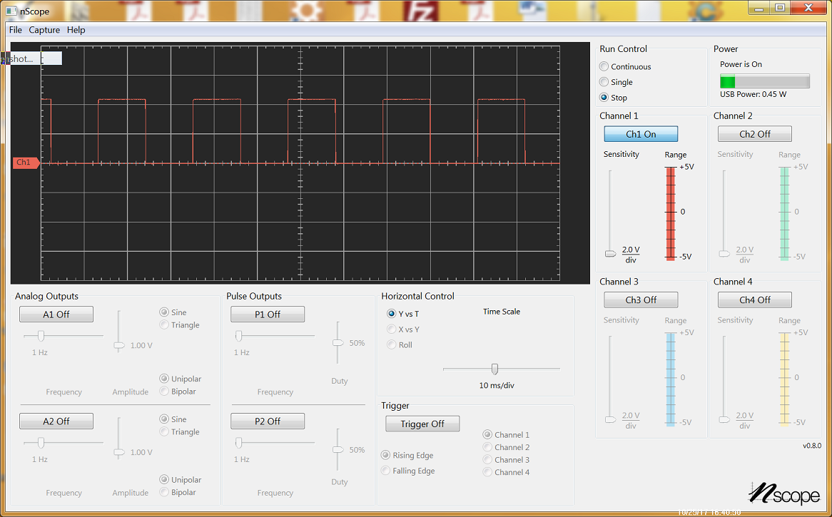

Continuing to poke at it there really is nothing labeled "VSS" on the "newer" Subarus and the signals coming off the transmission where the old VSS came off aren't clean square waves as shown on the prior oscilloscope traces. But I've now located a "vehicle speed output signal" line off of the Vehicle Dynamics Control. The documentation says it's a 0-12 volt pulse signal but my testing shows a 0-4.4 volt square wave signal (see image). The 4.4 volts is about the same as the 4.5 documented for the CAN bus though less than the signals off of the transmission speed signals. In testing so far the signal seems very clean and consistent and seems to work the Alpha-Pro very well. The major difference between it and the old VSS is that it ticks twice as fast, a tick about every 1.2 feet. Since my road test was only to 55 MPH I'll have to do some more testing to be sure I won't have to divide the signal pulses by two but things are looking pretty good at the moment. For anyone reading this my car is a 2013 Subaru Outback and I attached to the signal wire where it comes off of the connector to the VDC under the hood. Pin 11, green with black stripe (GB) wire. On my car I also note that there are molded-in pin numbers on the VDC side that the connector plugs into but the numbers are in the opposite columns compared to the numbers in the documentation so the molded-in label says 24. The GB wire ultimately, through several connectors, feeds into the speedometer/odometer on the dash. The only conditioning I've done so far is put a diode that my old Subaru's VSSs required to connect to the Alpha-Pro in the line but backwards from what was required on the old setup. I'm going to study that issue some more. Anyway I should be ready for the next POR without fussing with magnets.
Vehicle speed output signal at 40 MPH.
Jim White
Jim White
Posts: 10
Joined: Wed Aug 16, 2017 5:59 pm
Re: Subaru VSS to Alpha-Pro
Post by Jim White »
Just a further update. Testing at speeds up to 70 MPH continuous over 10 miles of interstate show that the "vehicle speed output signal" works reliably on my Alpha-Pro. I was getting errors in 10 miles of plus or minus .003-4 miles which is very reasonable and easily accounted for by slightly different cornering paths and weaving for traffic. At this point I'm assuming that the diode does nothing particularly useful but it doesn't interfere either though it does drop the signal a touch over .3 volts. If time permits I may do an optoisolator and maybe a selectable divider just for fun but I think I'm ready to rally. Thanks to all for the input.
